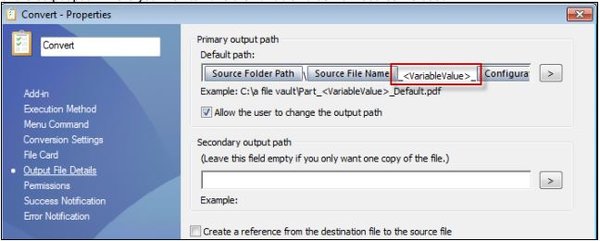

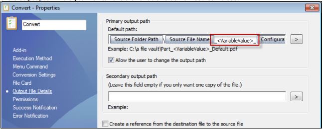

  1. Odpremo "Convert task" in navigiramo na zavihek "Output File Details". V ime izhodne datoteke dodamo niz "<VariableValue>" (brez navednic) na mesto, kjer si želimo zapisati vrednost željene spremenljivke.

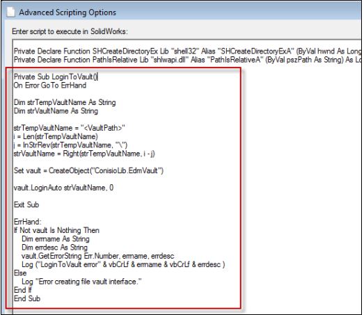

  4. Pod deklaracijami, dodamo naslednjo funkcijo - "LoginToVault" (funkcija poskrbi da pridobimo vmesnik do zalogovnika)
    Koda: Izberi vse
    Private Sub LoginToVault()
    On Error GoTo ErrHand
    Dim strTempVaultName As String
    Dim strVaultName As String
    strTempVaultName = "<VaultPath>"
    i = Len(strTempVaultName)
    j = InStrRev(strTempVaultName, "\")
    strVaultName = Right(strTempVaultName, i - j)
    Set vault = CreateObject("ConisioLib.EdmVault")
    vault.LoginAuto strVaultName, 0
    Exit Sub
    ErrHand:
    If Not vault Is Nothing Then
     Dim errname As String
     Dim errdesc As String
     vault.GetErrorString Err.Number, errname, errdesc
     Log ("LoginToVault error" & vbCrLf & errname & vbCrLf & errdesc )
    Else
     Log "Error creating file vault interface."
    End If
    End Sub

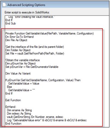

  5. Pod ravno dodano funkcijo, dodamo še eno funkcijo - "GetVariableValue" (funkcija pridobi vrednost spremenljivke iz kartice trenutne datoteke)
    Koda: Izberi vse
    Private Function GetVariableValue(FilePath, VariableName, Configuration)
    Dim File As Object
    'Get the interface of the file (and its parent folder)
    Dim Folder As Object
    Set File = vault.GetFileFromPath(FilePath, Folder)
    'Obtain the variable interface
    Dim pEnumVar As Object
    Set pEnumVar = File.GetEnumeratorVariable
    Dim Value As Variant
    If pEnumVar.GetVar(VariableName, Configuration, Value) Then
     GetVariableValue = Value
     Else
     GetVariableValue = ""
    End If
    Exit Function
    ErrHand:
     Dim ename As String
     Dim edesc As String
     vault.GetErrorString Err.Number, ename, edesc
     Log "GetvariableValue error" & vbCrLf & ename & vbCrLf & errdesc
    End Function

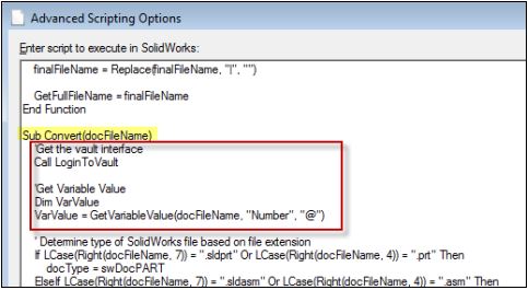

  6. Poiščemo funkcijo "Sub Convert(docFileName)" in dodamo naslednje vrstice, ki pokličejo zgoraj definirani funkciji.
    Koda: Izberi vse
     'Get the vault interface
     Call LoginToVault
     'Get Variable Value
     Dim VarValue
     VarValue = GetVariableValue(docFileName, "Number", "@")
    "Number" v vrstici "VarValue = GetVariableValue(docFileName, "Number", "@")" zamenjamo z imenom tiste spremenljivke, katere vrednost želimo zapisati v ime datoteke (skupaj z navednicami).

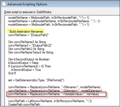

  7. Poiščemo sekcijo "Build destination filenames" in dodamo naslednjo vrstico, ki <VariableValue> niz zamenja z vrednostjo spremenljivke:
    Koda: Izberi vse
    convFileName = Replace(convFileName, "<VariableValue>", VarValue)

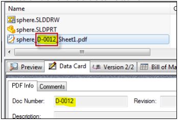

Ko se naloga zažene se mora sedaj v ime datoteke zapisati vrednost spremenljivke "Number".
