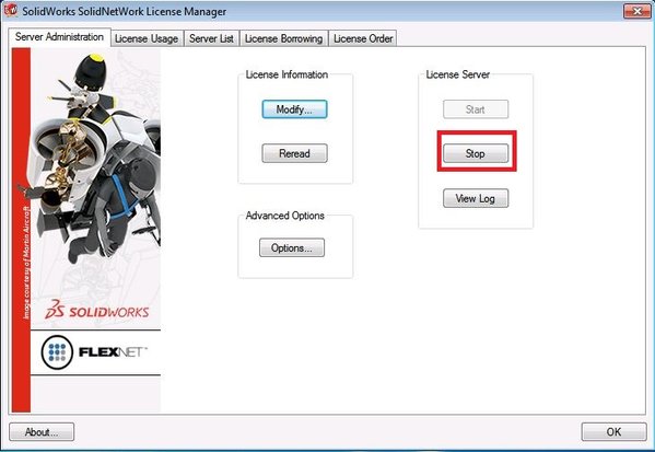

  1. Ustavitev obstoječega licenčnega strežnika (SolidNetWork License Manager -> zavihek Server Administration -> License Server -> Stop)

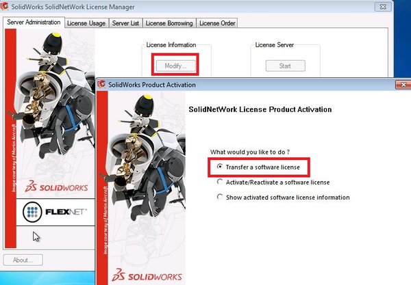

  2. Prenos obstoječe mrežne licence nazaj na strežnik (Server administration -> Modify -> Transfer a software license)

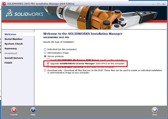

  3. Posodobitev licenčnega strežnika (DVD -> Server products -> Upgrade SolidNetWork License Manager)
